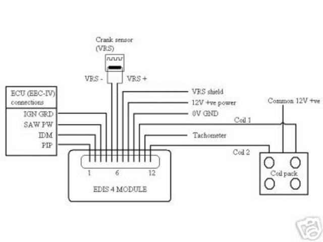

paulf
| posted on 20/3/05 at 07:49 PM |
Diagram attached.

saigonij
| posted on 20/3/05 at 07:54 PM |
lovely jubely!
how does the sheilder connect and to what! im guessing that is what the small connector is near the CAS, but i cant find anything to connect it
to!!!
If the ECU does not know the Car is cranking over, it will not add fuel right?
so all things point towards the CAS sensor, and the wiring...
for pins 6 and 5, i should get a beep on a continuity test between the CAS connector pins and the EDIS unit?
paulf
| posted on 20/3/05 at 08:03 PM |
The shield connects to ground, not sure about the actual physical method as mine is wired from scratch with some shielded network cable , I just
pulled the bits from a scrap car and made my own loom.
To check the wiring from sensor to edis plug i would just test the cable for continuity from one end to the other individally, or check for the sensor
signal at the edis plug when cranking.The edis may not show a circuit on your tester as it will have a high impedance input.
It should start and run without the sheld being grounded but advise you ground it to finish the installation to avoid any stray signal problems.
Paul.

She fired up today!!!
i had the wrong plug on the CAS sensor.
found a spare lead, plug it in to the right connector on the loom and fired first turn of the key!!!
We now have a motor fuel injected by uncle henry's finest EFi system!
