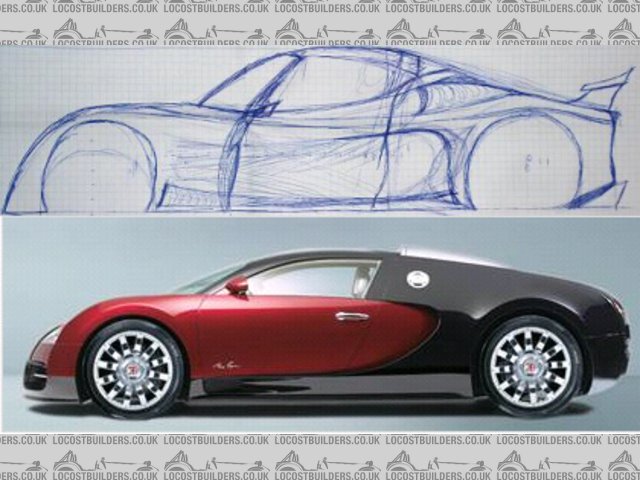

Hi everybody,
I've been really busy for my job but now I have some time to do some work on my personal project.
I'm drawing my first chassis in Solidworks and have been trying to draw something for the bodywork.
The car will have the possibility to remove the roof.
The windshield will be based on the GT40 windshield.
I hope I can draw some other sides of the car in the next days. After that I will have to draw it on my PC but I don't know which software I will
be using because I'm a newbie in 3D graphical stuff.
It should be able to draw sections of the bodywork and eventually also be able to convert it to a CNC file for some parts because I will be able to
use a CNC router from time to time.
Geoff

| posted on 27/12/05 at 03:37 PM |
The lights look too low and the front looks too busy or overcomplicated, from the side it looks just like all the others, GTM or whatever. You
don't mention the layout or drivetrain you are thinking of for it

| posted on 27/12/05 at 05:33 PM |
The design looks more set out for a transverse 4 layout than lengthways V with gearbox behind it. The engine will be a long way forward into the
driver area.

| posted on 27/12/05 at 05:50 PM |
This design is more than 440 cm long. If you look at the design you will see a V8 smallblock and a BMW V12 (from which I've got dimensions from
Andy) will fit in this design.
If you have a look at the Bugatti Veyron or other GT cars where big drivers can fit in, you will see the driver is sitting just behind the center of
the car.
Geoff
andygtt
| posted on 27/12/05 at 07:09 PM |
To be fair the first sketch does look a lot shorter and more elise size (& shape).
An elise is 3800mm long so your quite a bit longer, however I do agree that the driver does look a little too far back. I found it helped to visulise
the actual driver (head and bum mainly), if you do this it seems to far back.
I like the basic shape from the side although I'm not sure of the front end. It's hard to visualise what you had in mind from a basic
sketch though, so you might not be on the wrong lines.

geoffreyh
| posted on 27/12/05 at 09:49 PM |
Thanks for all the replies until now.
I have however one problem like you already mentioned. The driver sits far back. The problem is I'm 203cm tall and have extremely long legs.
If I have a further look I would be able to put the driver 15 to 20 cm more forewards but that's the most I can do.
You will find in my archive a picture with sizes for the driver. You will see I'll need like 155cm for myself whithout counting pedals space and
so on.
If anyone knows about another solution please tell me about it.
About the front sketch. I've been adding some comments to change some parts. You haven't however seen the back sketch. You can't
even see it's the back of a car. Really terrible. I will have to try it in another way.
Geoff

| posted on 28/12/05 at 10:05 AM |
If it's going to be a big car it looks out of proportion, like it will be too tall with massive tractor wheels and the driver perched high
up.

andygtt
| posted on 28/12/05 at 10:54 AM |
I'd agree it looks out of proportion but don't forget it is his first sketch rather than a scale drawing.
Geoff
I seem to remember you having a scale drawing of your chassis with the dimensions you need to fit, try scaling this to you sketch to see if it
matches.....
Also I gave you the basic dimensions for my chassis, have a look at my chassis pics with the seats in to get an idea of were the bulkhead has to
go.
MY bulkhead is leaning into the engine bay to give me extra room and maximise the space..... also my engine package could actually go back 100+mm as I
have pushed the engine forward as far as it could go as part of the design.
Keep up the good work.

| posted on 28/12/05 at 10:33 PM |
I'm trying to offer helpful criticism, I think drawing is a good way to form ideas and if you ask for input, be ready for constructive ideas
even if they don't coincide with your own thinking. I like to see a bit more rounding of the sides and less intricacy in the bonnet (hood) from
the front view but that's probably not what you want. It's your car, you do as you like, draw loads more and pick your favourite.
