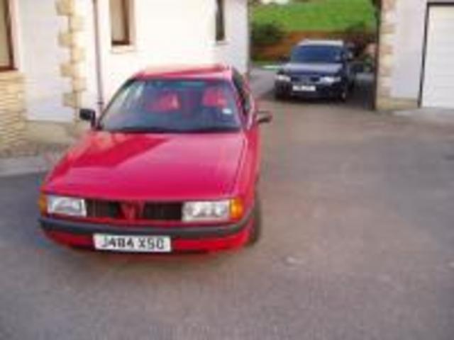

quattromike
| posted on 2/1/06 at 07:33 PM |
here's the beast in question:
