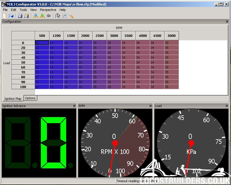

OK - I now have a working megajolt with a basic 2D map. The car is running very smoothly and accelerates well, but I suspect that it would benefit
from a 3D map as it now hesitates very slightly when I floor the pedal after pottering along on mid-revs (this didn't happen with the old dizzy,
but that had vac advance).
The problem is that I know three-fifths of very little about ignition tuning - I need some clues about how to develop the map. I could go to a
rolling road, but:
1. How many RR operators would know how to test and set up MJ using my PC?
2. I don't really have the spare cash to pay for an hour or two's worth of RR time.
So, all in all, a bit of guidance would be appreciated!
BTW: I'm using a MAP sensor connected to the vac advance outlet on a Weber down-draft carb. This gives me near-atmospheric pressure (~100KPa)
at tickover and low pressure (~20KPa) when revved up and under load. I think I've got that the right way round!
My current map is
HERE
All help appreciated!

Firstly close up the Vacume figures so the table only displays what figures your engine achieves.
If its 20kpa on full load and 80kpa on idle then any values on your table outside of this are a waste, and space them evenly across this range.
Where there is little Vaccume (load) i.e 80kpa) you can advance the timing, and where there's alot of vaccume it may need retarding.
A figure like setting off or flooring it might be say 2000rpm with 30kpa vaccume.. this would probably need retarding to get it to pull well without
hesitating or pinking.
A figure of 2500rpm with 60kpa vaccume would be a cruising speed or over run so it can be advanced.
Bugger can't find my maps on this computer.. .the Vaccume figures could be the wrong way round it takes some figuring out!.
Its best to try and tune it with 2 in the car.. the passenger just watches the run time display for where it pinks and then retards it in that area of
the grid the cursor is on when it pinks. Some sample maps of the net might be useful as a guide to compare yours with.

This gives me near-atmospheric pressure (~100KPa) at tickover and low pressure (~20KPa) when revved up and under load. I think I've got that
Yup. Wrong way around. Atmospheric will be at Wot and there should be substantial vacuum at tickover.
You total advance looks about right. I think I used to run my crossflows at about 38 max.
You should also be able to advance the low to mid range a bit on low throttle openings as this will help pickup and economy.
As I guide, under load you are most likeley to get pinking so at WOT you need to be careful how fast the advance comes in. Under light load and high
vacuum conditions the mixture burns slower and needs more advance. How much is really trial and error. I would suggest moving in small steps adn
progressive work through your map over the course of a few weeks.
I would start by bringing the advance on 3 degrees earlier at 30 or 40 MAP all the way through to max revs. Max advance here is not really relevant as
you are unlikely to see max revs on low throttle except overrun. Lots of advance is then useful to control popping through the exhaust.
Drive with this and see how it feels/sounds then move up one MAP range and start again.
I found logged my rpm and throttle settings at cruising speeds and them tuned that area first. After tuning, once the settings seemed good I would
find a hill and abuse the engine with lots of load to ensure no pinking.
Have fun but do it progressively. Don't rush it as you will likely jump in too large increments and will miss the sweet spot.

I've used this method to generate a table as a starting point for a couple of engines,
they've turned out to be pretty close to bang on so far. There' also some info about working things out on the
MS2 instructions that may be of use

I had a working map for a crossflow with Map sensor and downdraught carb a mild cam and 1300 pistons as was the spec of mine before injecting it. I
think it is still on my laptop and will look for it later this evening.
Paul.
| posted on 14/1/07 at 07:04 PM |
Well, apart from the 1300 pistons, that describes my engine quite well!
I would like to see that map, if you can find it - not necessarily to use it as-is (although it won't be too far away) but more to get an idea
of the shape of graph I should be aiming for.

The info on the thread sounds much like I did with mine, at high loads and low vacuum you need the basic advance with a maximium of 36 deg and as the
load decreases the advance should increase .it is really a trial and error type of thing but after some trials you will get a feel for it.
