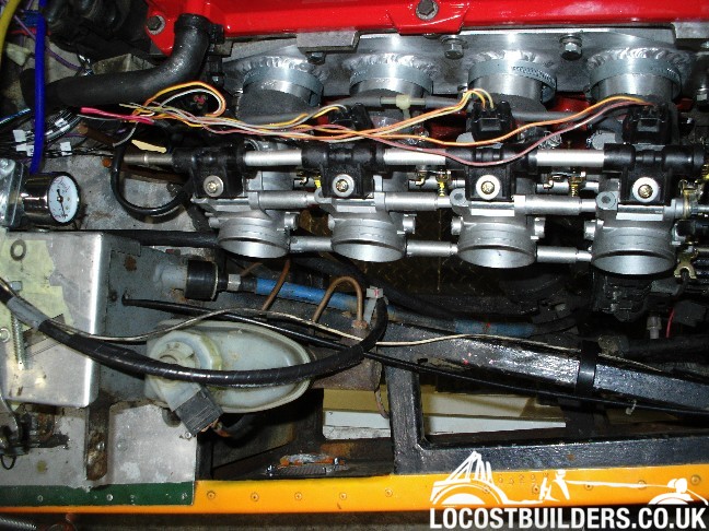

I have today fitted my TB's but am concerned that they are too close to the Master Cylinder.
The question is do I shorten the inlet manifold or find a way to move the Master Cylinder, probably remote.

stevebubs
| posted on 28/1/07 at 11:05 PM |
Hard to see the clearance issues in the verical axis - is raising the TB angle wrt the head an option? That way they will go over the M/C?

TangoMan
| posted on 29/1/07 at 08:10 AM |
Thats for the info.
I think I will get it running and them decide how to proceed. I will need to do something as the Pipercross Filter doesn't fit in the gap.
I guess I could always sell it and make a collector and remote filter.

bimbleuk
| posted on 29/1/07 at 10:15 AM |
If you go to the effort of fitting bike ITBs then don't fit individual socks as that reduces power. You ideally want a decent air box fitted.
Easy to say, hader to do in your case!
