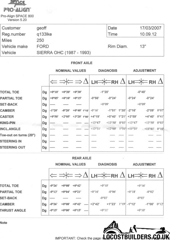

Thinking of getting my Indyblade setup properly but just wondering if anyone has any settings that they can give me for a blade powered Indy, at least
as a starting point.
thanks,

Chirs,
Trouble is I don't know what the geometry on the Indy should be set to.
Do you know where I might be able to get hold of these settings.
ta,
Rich.

Hi yer shortie
i had mine set up on the four wheel geometrey macine at work by an ex racer and pretty knowledable bloke
i must admit i only driven it a few times since but it feels much,much more stable at high speed and now it really really goes round corners and
deforms ur face
im off to lydden on good friday for a track day so can report back fully on the settings..
most of this info is using the sierra as base settings and some of it is irrevalnt for the indy, if you take it to somewhere with a four wheel geo
check they'll no what all these settings mean..
[img]http:// [/img]
Hope this gives you a base setting..that what i gonna do and see how it goes at lydden and go from there.
i also going to get it corner waited later so some of these settings will probably need adjusting but theyll do for now
The car will probably be way,way faster than me anyway so i might find this ok for a while
Geoff

Geoff,
That's great mate thanks for those, a good starting point.
