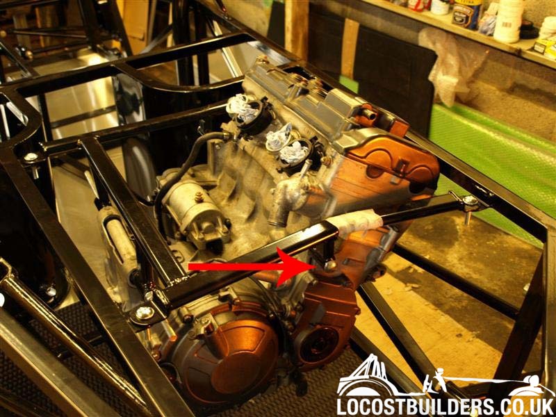

I placed my engine in today (893 Fireblade engine) and found that I need some more bolts (again). I don't know what size thread I need.
can anyone help with the thread size of the engine mounting bolt shown in the picture?
Mark.

iiyama
posted on 16/3/08 at 06:28 PM Reply With Quote
M10 fine I suspect

Mark G
posted on 16/3/08 at 06:37 PM Reply With Quote
Originally posted by iiyama
M10 fine I suspect
Thats what I thought, but I had a couple of bolts which I thought were M10 fine but they only screwed in about 2 or 3 turns before they locked up.
stevec
posted on 16/3/08 at 06:43 PM Reply With Quote
They are usually M10 x 1.25 pitch.
Steve.
Mark G
posted on 16/3/08 at 07:04 PM Reply With Quote
This sounds very precise.
Thank you.
Jason Fletcher
posted on 16/3/08 at 08:10 PM Reply With Quote
Mark
the M10 is normaly a 1.5mm pitch and are available anywhere. The M10x1.25 is a nightmare to get hold of in small numbers. If you are stuck for one let me know and I'll launch one out for you if Ive got one.

Jason Fletcher
posted on 16/3/08 at 10:57 PM Reply With Quote
Mark
bet you a fiver thay aint got any
J
Nick Skidmore
posted on 17/3/08 at 08:39 AM Reply With Quote
M10 X 1.0mm is also a favourite on Jap engines.
Custom Fasteners in Newport are good, they have a web shop.
Nick
indykid
posted on 17/3/08 at 11:31 AM Reply With Quote
any self respecting bolt shop should carry M10x1.25. all 3 of my locals do.
however try getting hold of M10x1 prop bolts in anything other than 8.8.......that was a struggle.
