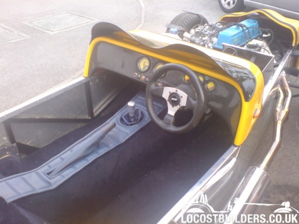

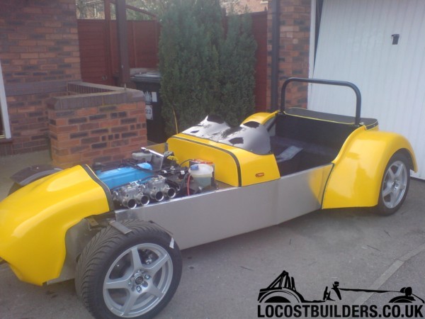

Just had a pretty good day building the Supercat so thought i'd share some pics. Just started fitting the nose / bonnet and halfway through
making the pedal box, but other than that we arent that far of completion.
Here ya go anyway.....

whats that black stuff in the footwells
Paul TigerB6
| posted on 22/4/08 at 09:26 PM |
That be blue shagpile - errr carpet. Far too heavy for my own car though that stuff!!

AERO SCREEN
paul did you have to modify the scuttle to get the aero screen to fit?
Paul TigerB6
| posted on 22/4/08 at 10:37 PM |
I did indeed have to modify the scuttle so its definately a one way conversion to fit the aeroscreen. I ground down most of the front lip and a small
amount of the rear lip where the screen fits to get the aeroscreen to fit nicely. Using a rotary sanding wheel and some patience its possible to get
the screen to sit nicely on the rear lip. This does leave a gap of about 10 - 15mm in the scuttle top so ideally a couple of layers of fibreglass
could be used to bridges this. I have a few other ideas of what i'm going to do with my B6 scuttle but this is getting painted anyway so will
be fairly heavily modified (and is slightly different to the cat anyway.)
Only thing i wasnt overly happy about is the passenger side indent just in front of where the wipers wheelbox is doesnt quite get covered by the
aeroscreen. Typical Tiger unsymetrical panels!!
milson
| posted on 22/4/08 at 11:54 PM |

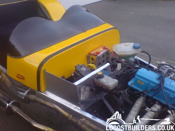

looking good ,rear cover fitted ok .Like the size of the battery what is it?
Paul TigerB6
| posted on 23/4/08 at 05:57 AM |
Yes the cover fitted great thanks Milson. For those that dont know, Milson makes these and sells them via ebay along with other trim bits for the
Tiger at really great prices (half of Tiger's own prices).
The battery is an
Odyssey PC545 held in a
bracket from Optimum Balance Products who are traders on the forum.

I see the spare wheel carrier has been removed.
Did you add any support for the body tub?
That is the same mod I had in mind.
Paul TigerB6
| posted on 23/4/08 at 03:12 PM |
I did indeed. In that last pic the black strip across the bottom edge of the tub is a piece of powdercoated angle aluminium that goes inside the line
of the body. This was then drilled and bolted to a second piece of aluminium angle (forming in effect a U shape) which was in turn rivetted securely
to the chopped down spare wheel carrier. This was done simply by chopping out the required amount and then the end plate was welded back on like in
the pic.
