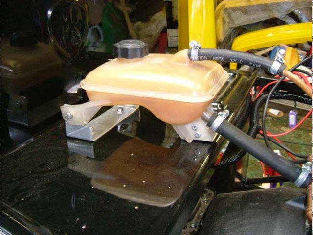

| posted on 25/10/04 at 12:13 PM |
will it work to shift this rusty cr*p in mine?
at the minute it's spoiling my engine bay
cheers

indykid
| posted on 25/10/04 at 12:15 PM |
here's the pic - ooooops, sort of forgot it last post.

Deckman001
| posted on 25/10/04 at 12:30 PM |
Mine was worse than that before i started, it looks brill white now with just the washing powder trick !!

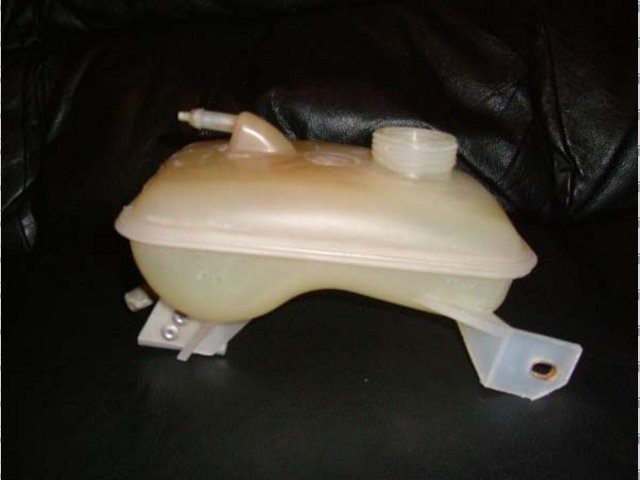

indykid
| posted on 27/10/04 at 10:00 PM |
so will it come any cleaner than this? (compared to pic on page 1 of this thread)
this is using horticultaral grit and non bio, daz citrus fresh works better than persil. will try vinegar now, and dishwasher, when we have a bit more
powder. would'nt want to use the last bit now would i
