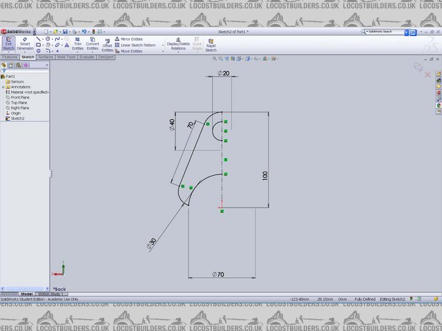

Steve Hignett
posted on 19/12/09 at 11:42 PM Reply With Quote
luke
posted on 20/12/09 at 12:30 AM Reply With Quote
looks perfect to me! it fully dimensioned?
down bottom corner it will say under defined or fully defined.
Steve Hignett
posted on 20/12/09 at 12:48 AM Reply With Quote
luke
posted on 20/12/09 at 12:55 AM Reply With Quote
I can't tell cos I'm on my phone and the image is small, on my version on the bottom bar at the right hand side it says wether its fully defined.
Other way to tell is look at everything in the tree, if there is a (-) next to it its under defined.
Steve Hignett
posted on 20/12/09 at 12:59 AM Reply With Quote
I just have plusses next to everything Luke, so hopefully it's a-ok!!!
When you see the image you will hopefully be able to confirm that, but I'm happy so far, so thank's for all your continued help!!!
luke
posted on 20/12/09 at 01:07 AM Reply With Quote
Should be sound then! You just don't want the workshop having to ring u for dimensions!
