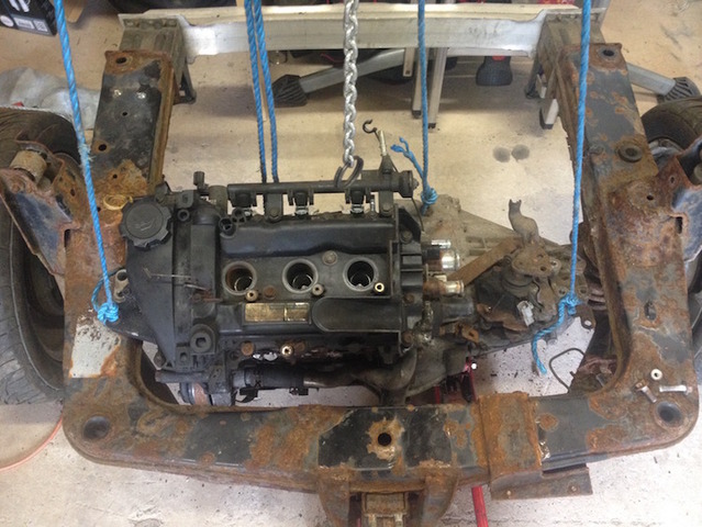

I went with the Aygo engine in the end. The good news is that the engine and box fit.
I'm not sure how I'm going to deal with the offside engine mount as it's solid and sits above the subframe. I was hoping it would
go below, so I could simply drop the engine from underneath should I need to.
If that's not an option, then I'll just have to plan the electrics / plumbing to allow for easy subframe removal (it is only 4 bolts after
all).
I also plan on using TB's from a Triumph Speed Four as these roughly have the same port size / shape. Again, it involves a bit of fabrication
as I need to lose one of the bodies, but it's no big deal.
And that's ad far as I've got just now...

Nice, that fits rather neatly, and I happen to know of a recently written of Aygo
Did you know there's an aftermarket turbo conversion for this engine?

| posted on 27/10/15 at 05:49 PM |
Cheers Ugg. The 955 ones are too big to get them in-line with the 1KR-FE inlet ports (even with linkage modification).

Scootz, could you fabricate a new engine mounting bracket to shift the mounting point under the subframe, and then use a stabiliser bar from the front
of the subframe to the cylinder head (like a classic mini) to stop it twisting?
EDIT: scratch that, just seen it's a big cast lump that's part of the timing cover. You could hack it off and have it alloy welded I
suppose.
