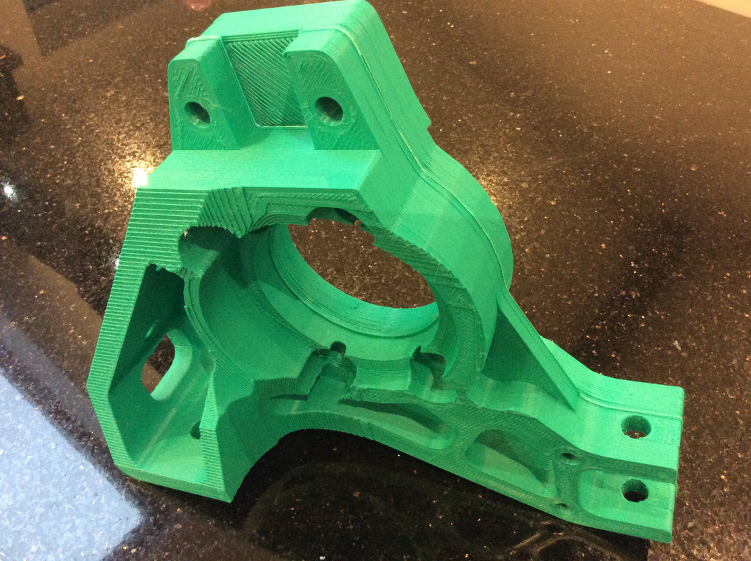

I bought Creality CR10S pro a couple of years ago now and done loads of prototype work on it for the locost, you will have seen a bit recently on my
mid engined (now) 2.4 20vt.
Latest work below:
The print didn’t come out as well as usual - I suspect the batch of filament and a nozzle change needed. I printed this with a 0.8mm nozzle and a
layer height of 0.5mm, total time for the two halves around 16hours. The neat trick I have just mastered is you can locally change the properties of a
single model, really helpful for a structural part like this. The aim is to get the wheels on and lower the locost to the ground next weekend. THIS IS
MOCK UP BEFORE YOU ASK, but I know a less reinforced earlier version supported the engine and gearbox, 220kg, so with out the motor in, I think I’ll
achieve my goal of getting it on its wheels and “rolling” it for the first time.
I would highly recommend to anyone getting a printer, it’s a must have piece of kit, and I recommend Creality. I’ve had a really good luck with mine,
I have modified it a bit to get it to run better and believe the V2 spec of the CR10S has a lot of the upgrades you want. I think you need to prepare
yourself for a certain level of experimentation, it’s just the number of variable both the machine and software can change, materials vary a lot
too.... so just be prepared to spend an amount of time setting it up. Over the last few years I’ve really hammered mine and replaced bits as I went,
most extreme print was in ABS and 90 hours, it printed fine at 250deg C for most of the week!

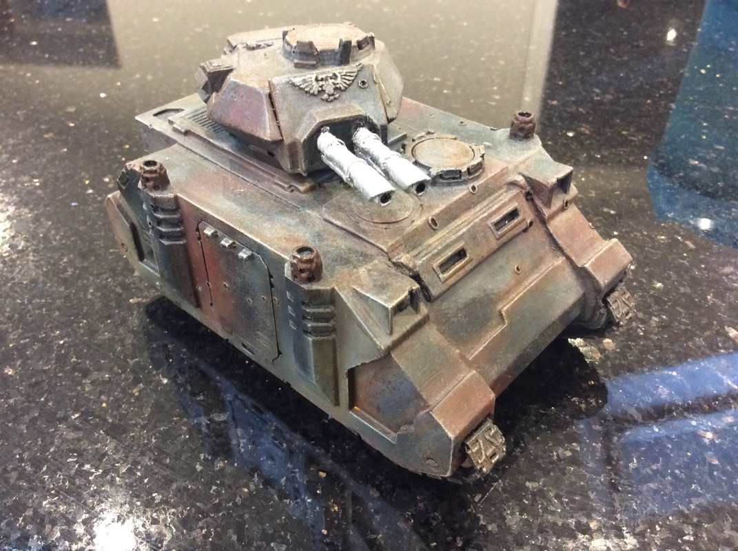

I did a warhammer Tank last winter, think I could have printed it with a finer nozzle but on a standard 0.4mm the actual printed lines are pretty hard
to see once painted:
It isn’t finished, I wanted to put decals on it and paint it for snow use like a German tiger tank....

On the tank I just sanded it down a washed it with Acetone. For my locost parts I’ve just left them as are as it’s prototype work.
