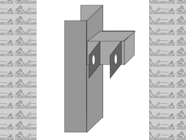

Can always do it like Pete has suggested by welding a section of box vertically onto the back of the trailing arm bracket with two horizontal
"lugs" for the rose joint.
Pat...

| posted on 6/8/05 at 09:23 AM |
if i were to do it petes way, i would use a piece of 50x50x3mm box section, cut to a diagonal and with a 3mm plate on the back. This would ensure that
the bracket fits with no overhang.

Rorty
| posted on 6/8/05 at 01:44 PM |
That would do, but JoelP's triangular version would be neater and stronger. I would angle the RHS so the tabs are aligned with the Panhard
rod's axis, then sandwich the tabs either side of the rod end and bolt the lot solid before finally tack welding them to the RHS. Only tack the
tabs at this point as you don't want to get any heat into the rod end.
Cheers, Rorty.

Avoneer
| posted on 6/8/05 at 02:36 PM |
Cheers guys and Rorty for the pic - that'll be the solution.
