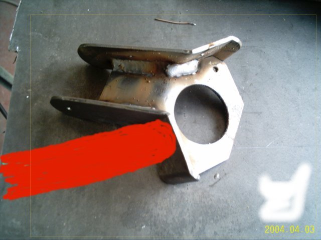

jcduroc
| posted on 15/4/04 at 09:11 PM |
OK guys don't laugh because I'm really not gifted for drawing on PaintShop.
This is how I'm making my lower wishbones (Should be completed next saturday).
These are made for the Austin Maxi balljoints (Quinton Hazel QSJ602BLU) and the "things" to the left are the coilover mountings, going down
at 45º from the plane of the wishbone; these are intended to be as close as possible to the balljoint "action" point.
The tubes (that thing in red) come as convergent as possible to the same point and are made of 25 mm w/ 2 mm wall thickness (instead of the available
20 x 2.6); as someone said increase the diam. not the wall (moment of inertia).
I'd appreciate your (ponderate) comments on this design.
It would also be very pleasant to see some real calculations on all those bending, torsion, tension and compression loads (strains?) in the
"shi...est" situation described: braking (at 1G), taking the bend (1.2 G cornering, please) and hitting a bump (3G vertical?); come on guys,
share your skills!...
João
[Edited on 15/4/04 by jcduroc]

JCduroc that looks like a very nice peice of construction; putting the spring/damper bolt in line with the balljoint will remove the beam/bending
stress from the wishbone tubes, but will probably increase the angle of the suspension unit from the vertical leading to a worse "reducing
rate" issue under bump. Design is all about compromise..!
Your design is clearly quite different from the book design in this respect so cymtriks analysis won't apply. Unfortunately my mechanical
engineering is qualitative beased on experience rather than quantitative based on thorough knowledge of the application of structural analysis so
I'm just glad cymtriks is on hand to give authoritative nuggets of wisdom when he does!

britishtrident
| posted on 16/4/04 at 08:09 AM |
jcduroc --
I like where the bottom of the damper mounts it brings the line of action of the force close to the ball joints centre line.
You could cut/grind away quite a bit of metal as the vertical plates approach the ball joint centre line without affecting the the
strength/stiffness.
Add a couple of nicely chamfer webs down from the wisbone tube to the damper mount and it looks good.
(also nice welding !)
| posted on 16/4/04 at 08:12 AM |
that is one benefit of the maxi ball joint over the cortina one, due to it being smaller you can get the shocker closer to it. I made mine so close
that the spring nearly hits the upper wishbone in droop! but i think thats because my top mounting point is quite far out. With a maxi ball joint you
could have the points in line nearly, if you follow my drift.
BTW, how many of you dreamed about failing wishbones last night!?!?!? i certainly was pushing the car home in a dream...
