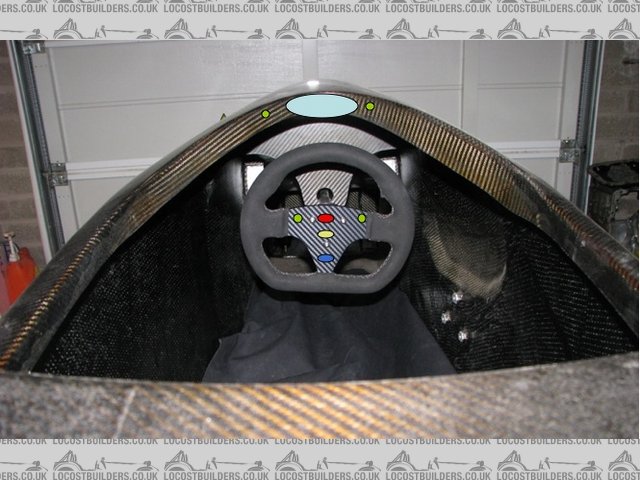

Been thinking of instrumentation and switches. As I've already mentioned a dozen times - the cockpit is tight!!!
It looks in the photo as if there is sufficient mounting space on the panel behind the steering wheel for the display / controls. Unfortunately
it's just an illusion - there is no space!
Sooooo, was thinking of putting the switches on the steering wheel, and the display / tell-tale lights on the 'lip' at the front edge of
the cockpit...
The blue oval being the display (wired to also act as the position light tell-tale).
The green circles either side being the indicator / hazard tell-tales.
On the wheel:
The two green circles being the indicator switches.
Red oval being the hazard switch.
Yellow oval being the dip / main switch.
Blue oval being the horn switch.
It's Evolution Baby!

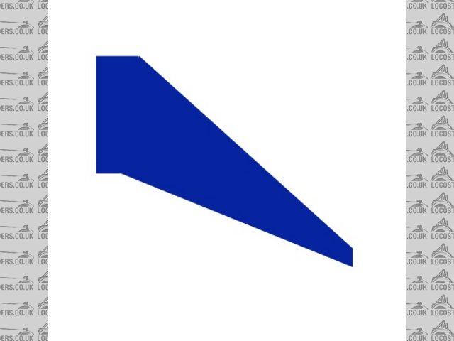

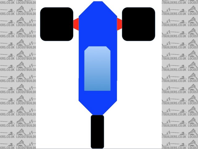

The main problem with building a front-subframe to take double wishbones (in my circumstances) is that the wishbones would need to be narrow, and they
would have to be pretty long to make the 'magic' 1:6 ratio.
The other issue is that they would have to be shaped something like the following pic so that the wheels weren't sitting right at the front end
of the vehicle (it would make the wheelbase / track insanely long and would look awful).
I'm thinking that such a long / narrow wishbone would have to be made of kryptonite or cast iron to prevent it flexing (snapping!) under load???
Can anyone offer any opinions?

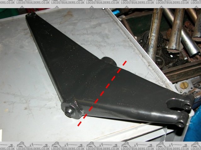

I think I previously mentioned that a Formula Vauxhall Lotus uses an upper wishbone that's about the required shape, but it would need
the rocker 'section' cut-off as I couldn't go inboard with the shocks and I would need to use them for top AND bottom of the
trike...
But would 4 of these last long???
Or could I abandon the 1:6 theory altogether and fit two (very) wide wheels (F1 stylee) up front on short stubby wishbones (narrowing the track) with
LOTS of travel, so that the machine leaned lots in corners, but still retained a large rubber contact patch on the outside wheel???
All thought welcome... particularly those suggesting that I should step away from the computer and never think about designing my own build EVER
again!

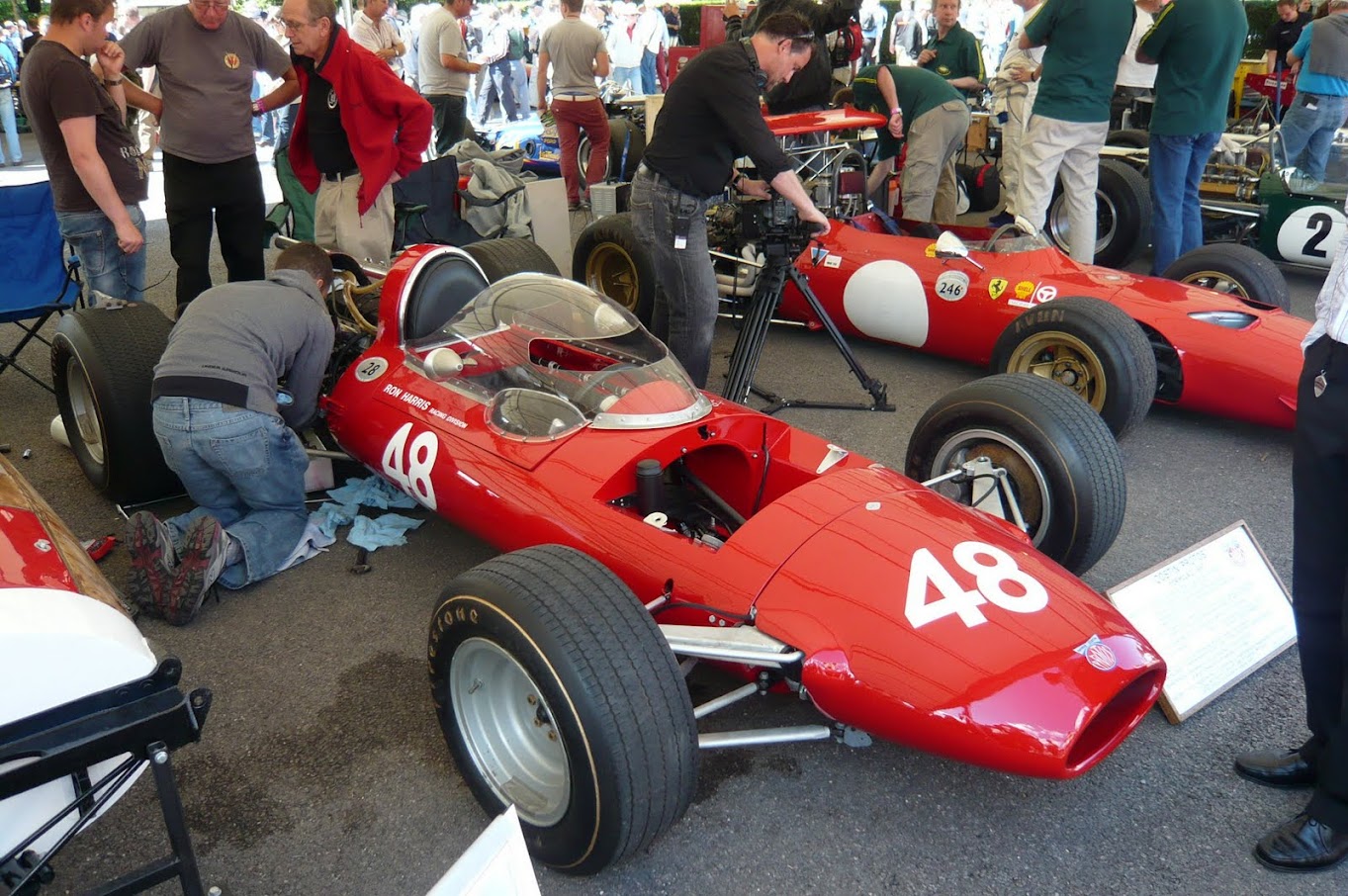

Do a Google Images search for 'Frank Costin Protos'.
The Protos suffered big problems with judder under braking, due to the raked suspension arms flexing, and I believe they later fitted additional
radius arms to cure the problem, but to be fair that was a slick tyred racing car under racing conditions with a top-notch professional driver: Costin
himself reported that he couldn't replicate the problem when he drove the car, 'cos he couldn't drive it hard enough.
But as I've suggested previously on this thread, I think you're getting too hung up on retaining the existing 'hard points' on
your tub: it's really not that difficult to bond in additional hard points for the suspension wherever you want them, if you know what
you're doing.

Yup... that's the type of wishbone I envisage - but it would need to be top AND bottom.
Unless I could bond a simple metal strut across the ali-honeycomb floor panel at the knee area that could incorporate the left and right rear-most
lower wishbone locating points (the forward ones being clevis type mounts attached to the face of the footwell bulkhead)???

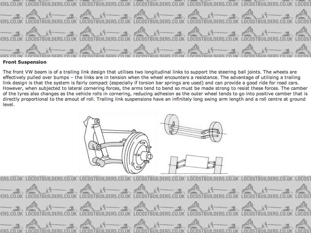

Would I find the handling characteristics of a trailing-arm beam-style set-up to be a problem... probably not!
This piece explains the handling peculiarities for those who are not familiar with it...
The dune-buggy guys have some pretty neat beams with top and bottom thru-rods instead of torsion leafs, and control the arms movement through coil
over shocks. I guess I could arrange for a MUCH more discreet and MSVA friendly shock tower to be fabricated and welded to the beam as I only need a
fraction of the travel they require.

quote: Originally posted by scootzThis piece explains the handling peculiarities for those who are not familiar with it...
At risk of stating the obvious, having a system where the front-end grip falls off as roll builds up is not necessarily a problem for a reverse
trike.... better that than the other way around!

Did some measuring and the wheelbase is going to be 293cm. So, I'm looking at a track width around 183cm.
