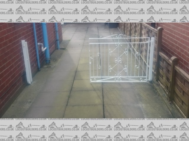

A couple more distractions, first of all, the gates needed to come in for a repaint.
![](/galpreviews/DSC_0496.JPG) ![GateDistraction](/gallery/DSC_0496.JPG) GateDistraction

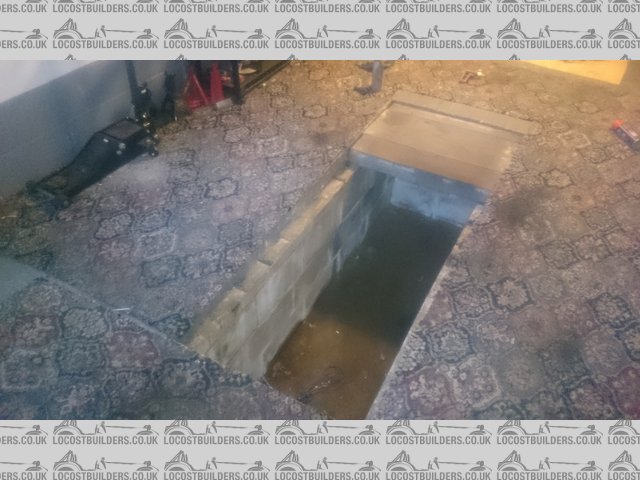

And then the tin-top needed rear pads and brakes, and was due its 2-yearly hydraulic fluid refresh. Brakes went fine, and gave me an excuse to use the
pit, but obviously the maintenance department at British Transport Police couldn't be bothered refreshing the fluid in the clutch, it was pretty
dark. Managed to screw up the clutch fluid refresh and ended up with a lot of air in the system to the point I couldn't move the car However,
it turns out that I was just bringing the pedal back up too quickly and creating a vortex in the brake fluid reservoir that sucked in air. All sorted
now though

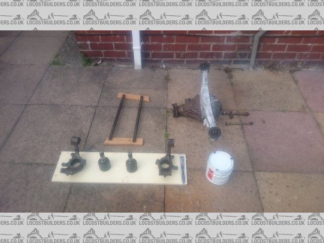

So back to the kit car it was. The diff was pretty filthy with some very thick areas of rust.
![](/galpreviews/DirtyDiff.jpg) ![DirtyDiff](/gallery/DirtyDiff.jpg) DirtyDiff
Whilst I do have electrolysis equipment handy, for the small items it was just as easy to use the wire brush in the angry grinder.
![](/galpreviews/2Cleaning.jpg) ![Cleaning](/gallery/2Cleaning.jpg) Cleaning

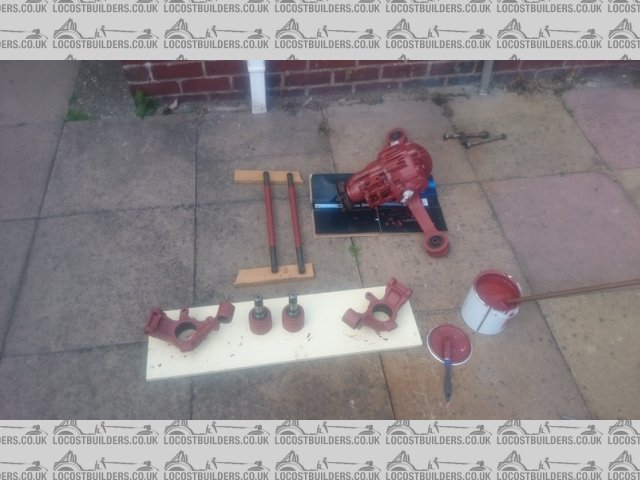

And so it was all cleaned with spirit and prepared for painting. CV joints were removed from the drive-shafts to aid painting, for inspection and to
pack with fresh grease and put on new gaiters.
![](/galpreviews/AwaitingPrimer.jpg) ![AwaitingPrimer](/gallery/AwaitingPrimer.jpg) AwaitingPrimer
And the primer I used was great stuff, it's a quick-drying zinc-phosphate primer and boy did it dry quick! By the time I'd done the first
coat on all the parts, I could lay down the second coat. Really stuck fast to the surface, except the really recessed parts of the diff where there
was obviously a touch of oil still left.
![](/galpreviews/Primed.jpg) ![Primed](/gallery/Primed.jpg) Primed
Unfortunately, the undercoat I've put on is not so fast drying, so that was me done for the day. The parts will eventually have 6 layers of
paint, two of primer, two of grey undercoat and two of black gloss. The idea behind using different colours is that I can see where the paint has
chipped and in need of a touch-up. If I see red, I know it's definitely in need of a touch-up. Unfortunately, I quite like the gunmetal grey of
the undercoat, but I've already bought the black gloss.

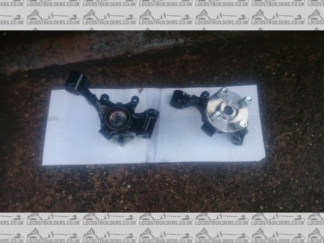

The eBay press required a little ingenuity to get set up correctly, but it worked incredibly well.
![](/galpreviews/Press.jpg) ![Press](/gallery/Press.jpg) Press
Rear hubs were rebuilt in next to no time.
![](/galpreviews/RearHubRestored.jpg) ![RearHubRestored](/gallery/RearHubRestored.jpg) RearHubRestored
And trial assembled on the restored driveshafts. Plenty of anti-seize paste will be going on between the driveshaft and the hub, not going to go
through all that fun again if I need to in the future.
![](/galpreviews/DriveshaftRestored.jpg) ![DriveshaftsRestored](/gallery/DriveshaftRestored.jpg) DriveshaftsRestored

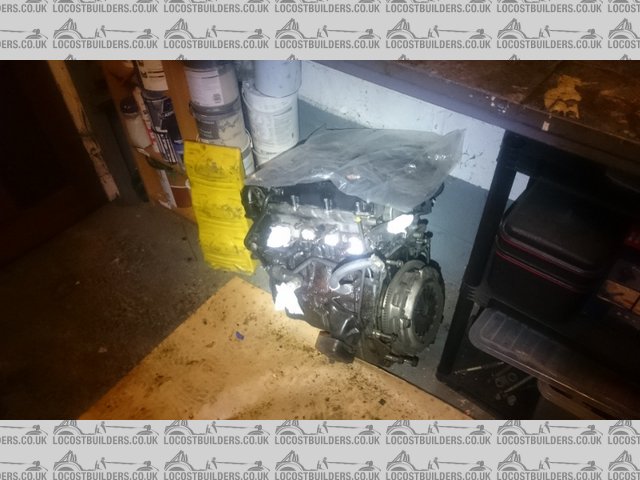

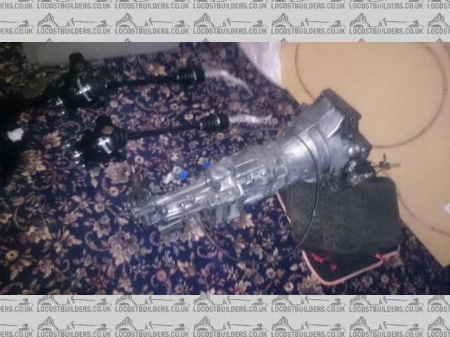

In anticipation of the new arrival, I decided to get the engine and gearbox split so I could put them somewhere sensible. Also, I'd rather not
trip and impale myself on the gearstick.
![](/galpreviews/21Engine.jpg) ![Engine](/gallery/21Engine.jpg) Engine
Engine is due a clean, paint, new timing belt kit and clutch.
![](/galpreviews/14Gearbox.jpg) ![Gearbox](/gallery/14Gearbox.jpg) Gearbox
Gearbox just needs a clean, turret seal renewing and filling up with gearbox oil too. I can see why the MX-5 is becoming a popular donor choice, that
gearbox is ridiculously light.
[Edited on 21/12/2015 by micksalt]

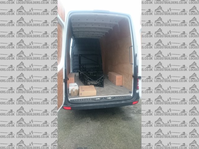

Turns out that the Mercedes Sprinter with 4.4 m load bay was a tad excessive coming to collection.
![](/galpreviews/Sprinter4m.jpg) ![Sprinter4m](/gallery/Sprinter4m.jpg) Sprinter4m
And here it is at home ready for unloading.
![](/galpreviews/Unloading.jpg) ![Unloading](/gallery/Unloading.jpg) Unloading
Didn't have time to put things away neatly, so very grateful for the oversized garage that came with the house.
![](/galpreviews/LoadsOfRoom.jpg) ![LoadsOfRoom](/gallery/LoadsOfRoom.jpg) LoadsOfRoom
