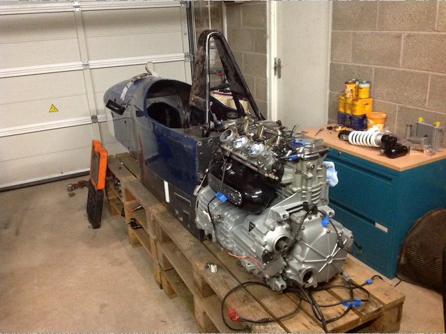

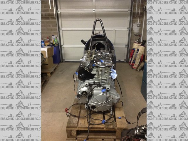

| posted on 11/4/13 at 08:59 PM |
Not done much... just removed the secondary butterflies from the TB's and mocked-up the layout.
It's Evolution Baby!
