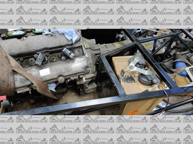

| posted on 8/7/21 at 07:59 PM |
It Fits!
It only bloody fits! :-D
  Engine Fits
It is tight though...
  Gearbox tight
Current head scratchers to sort (any ideas?):
Clutch master cylinder needs to be 90mm max, current one is too long
Reverse switch on the gearbox can't be installed as the 'box is hard up against the chassis
Ground clearance is about 50mm
Once I have nailed those I can move onto engine mounts, exhaust, clutch, flywheel (and compatibility with the starter), engine management, prop shaft,
oil filter and inlet manifold spacers. Then the engine swap aspect is complete and I can continue building the car!
big_wasa
| posted on 8/7/21 at 08:09 PM |
That’s made me smile
Re the slave, what about a concentric slave in the bell housing ?
Re the reverse, if it’s registered and doesn’t have one fitted you don’t need one. But I didn’t think the switch stood out that much.
I hope to get back on with mine at the end of the month. Just trying to get the car more ready to take it.

Partofthechaos
| posted on 8/7/21 at 08:25 PM |
It's the master cylinder which is too long, not even thought about the slave yet!
The reverse switch isn't massive, but still too big for the current location, I will get a picture tomorrow to explain. Unfortunately it still
needs to be IVAed. Think the chassis may need some adjustment.
