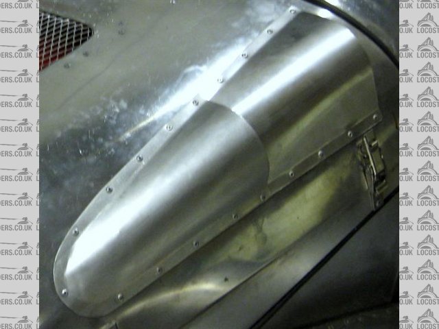

2cv
posted on 8/11/10 at 07:56 AM Reply With Quote
It's just my opinion, if you have an aluminium bonnet particularly a polished one it is good to have aluminium fittings rather than fibreglass. The bulge can be polished as well and it all looks like one part rather than an add-on. The bulge can be riveted on as the extraction flutes in this picture.
[img] Description
If you do decide to have a go you'll be surprised how easily the aluminium forms but I'd recommend that you use either a wooden mallet with a rounded head or a piece of hardwood shaped to the kind of radius you want and hit that with a Thor hammer or the like. You actually don't have to put an awful lot of shape into it to give the clearance you need.
If all else fails, I'll be pleased to make one for you for the cost of the postage.
atb
John
