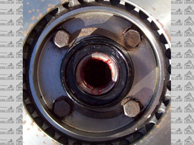

do they look like this? -

took a bit of searching but there they are fitted -
a close up - don't say I'm not good to you
