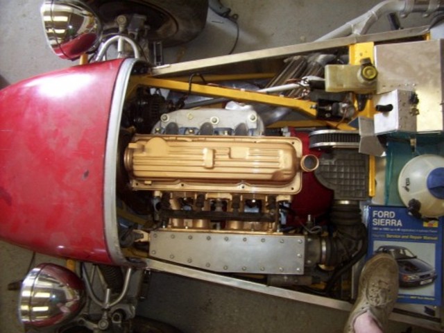

Sounds even better, I have just finished setting up the cam etc, and did not want to disturb it all again Rescued attachment Engine Overhead.jpg

ady8077
posted on 25/7/04 at 08:57 PM Reply With Quote
Hi Mark
Just looking at your picture ( engine looks great )
You did have a dizzy fitted when you tried to get oil pressure didn't you?

Mark Allanson
posted on 25/7/04 at 09:07 PM Reply With Quote
Originally posted by ady8077
Hi Mark
Adrian
The mist of ignorance has just cleared, no I didn't have the dizzy fitted. I didnt realise that the auxilliary shaft drives the oil pump VIA the dizzy shaft. WHAT A PILLOCK

MikeRJ
posted on 25/7/04 at 09:22 PM Reply With Quote
Originally posted by Mark AllansonWHAT A PILLOCK
I'm sure we've all been there one way or the other!
Interesting injection system though! Is that a set of throttle bodies or a modifed twin DCOE manifold? If the latter, how did you mount the injectors?
Mark Allanson
posted on 25/7/04 at 09:29 PM Reply With Quote
Try this Mike
If you can keep you head, whilst all others around you are losing theirs, you are not fully aware of the situation
MikeRJ
posted on 25/7/04 at 09:52 PM Reply With Quote
Cheers Mark.
I'd seen the RH article before, but it looked a bit rough and ready with original plenum mounted at 90 degrees and the small patches blocking off the original holes. You've made a very neat job of that!
Mark Allanson
posted on 25/7/04 at 09:57 PM Reply With Quote
I saw the RH jobbie before I did mine - it looked a total bodge so I did my own, he was charging about £25 for the plans and the little patches - cheeky b@gger
