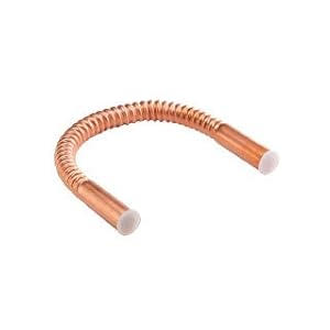

so convoluted coper pipe better for plumbing in shower?
