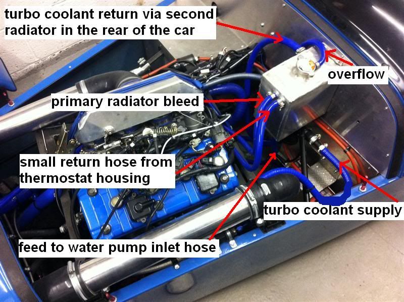

I think your design looks ok, but do you not have a small hose coming from your thermostat housing?
I've labelled up my engine bay in the photo below, so you know what each hose is connected to.
[Edited on 2/1/12 by SausageArm]

Thanks for that!
No, there is no extra hose on the thermostat housing on my engine.
