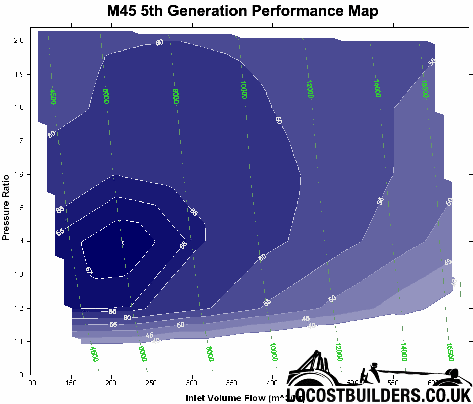

You really need to work it all out properly. I spent a lot of time sizing mine to make sure i could get the boost pressures and CFM that the engine
needed.
It all depends what your pressure ratio is, which will then tell you where in the efficiency map your ideal S/C RPM is.
There is a calculation in my blog on the link below to help you out. Its the most recent (latest) post, where i went back and confirmed my original
calcs.
The green line on the map is the RPM, so at 17000 RPM, youre way off. 6000 looks to be optimal to achieve the highest possible efficiency from the
S/C, but it depends on the CFM rate required. Im running at 14,000 to get the CFM needed.
