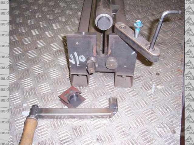

Edit to add pics of my 500mm set.
The rollers are made from LAS
home made rolls
home made rolls
[Edited on 6/9/12 by 907]

The pic shows my 4ft Edwards preset rolls.
The rollers are 3" solid hardened steel and even these flex a bit when rolling the full width.
Paul G
4ft pre set rolls
4ft pre set rolls
