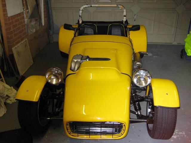

posted on 1/11/12 at 09:20 PM Reply With Quote
THX Big Wasa thats my yellow Avon in the picture the usual copyright charge of £0.00 applies to reproductions on here.
The manifold is off a Escort with a 1.8 silver top engine. Im running it with the Tiger supplied Webber Alpha engine management. It passed the SVA as shown in 2008 once I had filed off the EFI letters and made an alloy cover for the throttle actuator level.
If your engine is a 2.0 check about the water pump. It think it runs the opposite way to the 1.8.
