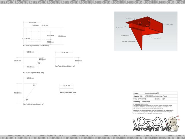

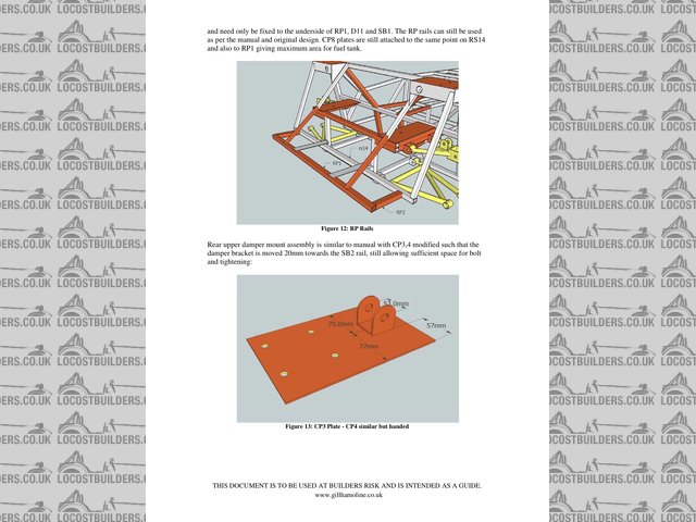

As some of you may be aware i started my build based on the Vodou drawings and when they ceased trading i then incorporated the bits i liked into the
saturn design as they were esentially very similar with the exception of the diff carrier and a few other minor bits.
Just about to weld the suspension brackets and i have realised that i did not pick up on the rear suspension bracket location when comparing the
two.
I have attached the 2 drawings for this area. My question is. Can the bracket be brought outwards to the outside of the car by approx 50mm so that it
will fit into the Vodou Bracket as drawn (and built) or should i cut out the Vodou parts and extend to match the saturn design?
Any ideas and cons of either. I need to get this done to kick on with the rest as it has hit a near dormant spell.
Vodou Design (as built)
Saturn (May seem more logical)

What was the driver behind going from Vodou to Saturn? Was there something specific in the Saturn design that you preferred?
Personally I think you need to use the whole rear end (IE from seat-back backwards) from either one or the other, trying to use the top plates of one
and the diff mount from another may put bars where you don't want them, or compromise the strength of the diff fixing.

would rather stick with the vodou rear end but need to know if i can move the suspension brackets out approx 50mm. As they were never drawn i dont
know if this was the intension.
I can extend to the saturn without affecting any other bar of the chassis so dont see it being a problem if it is necessary but would rather avoid it
if possible.

I don't know whether I'm just missing something, but I had a look at the Vodou drawings and I couldn't even see where the shock
absorber attaches to the wishbone? There is a fifth u bracket on the chassis, but the only way to use that one would be to have it fixed to the lower
wishbone. And it's central location would have it going through the driveshaft.
