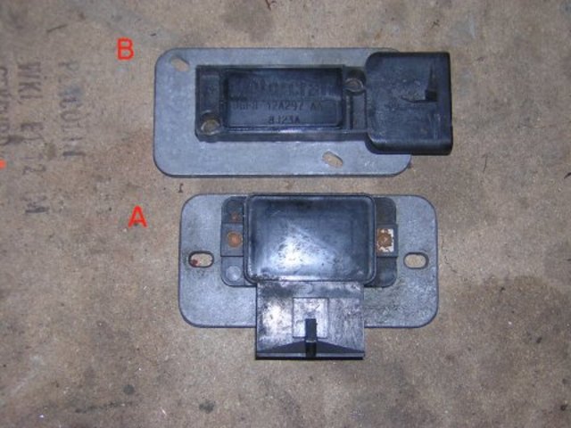

Let's see if photos of what I have will help explain things:
Amps I have:
Both Amps I have
Dizzys I have:
Both Dizzys I have
Amps:
A) Is definately from Bob
B) Is from my 2.0EFI '205' Sierra
Dizzys:
A) Is from Transit (so I'm told ) and has vacuum advance and two wires out
B) Is definately from my 2.0EFI '205' Sierra
I was pretty sure that using Amp 'A' and Dizzy 'A' I would be onto a winner.
I've used the Heynes wiring diagram which is for the 1.6 and 2.0 OHC engines. It all seemed so promising...

both amps have 6 connectors. I thought it'd be easy too! Comes from patching parts together.
Nick,
So I take it there are 3 different amps then? And I have versions 2 & 3?
'A' came from Bob!
"Motorcraft ESC2 ECU box" The only thing I have resembling this is the ECU from my 2.0i which I believe is the ESC4 or something!

James,
From your pics, module 'A' should work with dizzy 'A'. That should be the inductive discharge system with vacuum advance.
I've never seen module 'B' before so I'm not sure what that does!
Dizzy 'B' looks like the later Hall effect one where the vacuum advance is controlled via the ESC2 ECU unit.

posted on 20/10/04 at 07:36 AM |
module A looks just like mine (from a non steppered 1.6). the carb stepper motor usually has 6 wires going to it, how was your module A wired up?
there doesnt appear to be space for 6 extra wires out of it...

Just to confuse you even more i am possitive that amp (a) is the one i gave you
Anyway as the others have said Amp (a) and Dizzy (a) should work,i'll look for the wiring diagrams which i am sure are on this site somewhere or
