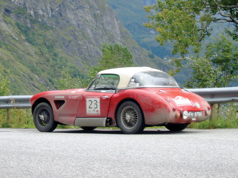

I would envisage welding up a soliencer that is not round, but one that fits the cross sectional shape of the sill and then cutting out the fiberglass
skin so that it is like an old works healey
http://3.bp.blogspot.com/-RhShsPVxack/Tv9C34MWWfI/AAAAAAAAATQ/eKD6bocy9K8/s1600/44079k.jpg
put two perforated pipies through and do a mandrel bent U bend on the front end and exit in the normal place in front of the rear wheels.
