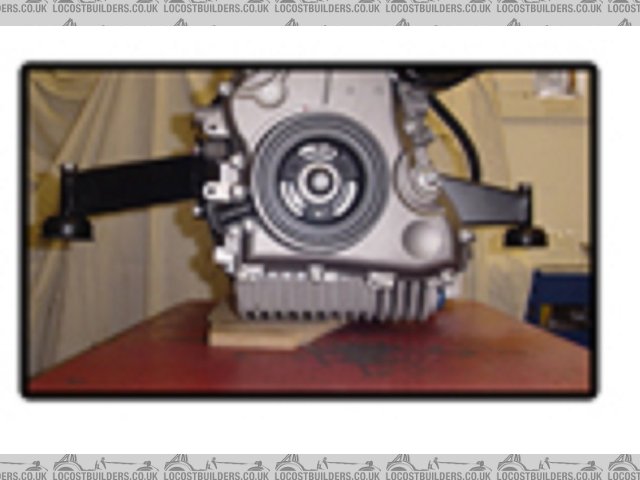

I've now got my duratec engine/ mx5 gearbox combo temporarily sitting in the car and am measuring up for mounts so exciting start to 2016. My question is, is it better to get a slight upward angle on the engine mounts, or would it be ok to simply have them parallel to the ground. I'm planning a similar design to the below picture. The height of the top of my rubber mounts means that instead of an upward angle shown in the picture, I could simply weld the box section i'm using flat to the top of the rubber mount and square to the plate on the engine meaning very little cutting at any angles

apologies for the very poor picture, but I blew it up from a thumbnail. The raceline Duratec mounts have a very shallow angle on them particularly the passenger side. Any issues with replicating this, or is the load better transferred in the picture in the earlier post?

An angle always looks better, but a mount is a plate bolted to the engine and a plate on top of the rubber mount.
How and what you link them with matters little, pipe, box, channel, even an I beam (if small enough ) would work.
( I wouldn't use angle though as it twists. )
The main thing is that the material is thick enough. Those plates bolted to the engine in your example pic look thin.
Several people have had mounts fracture for this very reason.
I have used 25 x 25 box with 3mm wall, and 4mm plates, but mine are SS so a tad stronger.

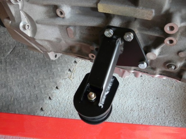

Hi bud. Just thought I'd mention that I used the next hole along as per your first picture and caught 3 bolts in a triangular fashion. I had to do this as my exhaust manifold was touching the mounts. It bows clears perfectly. Ps I used 75x25 box section

Not got many good pictures of the engine mounts in mine but found these few. As you can just make out the exhaust side is a very shallow angle and the inlet side is a little more angled.

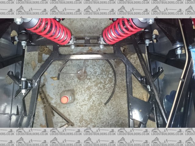

I seem to recall the OP asking about the front crossmember in a Striker with a Duratec install but I can't find the thread. This is how my chassis has been built to take a Duratec if it helps. As far as I know this chassis section was like this from new by RAW.
Front crossmember
Front crossmember
