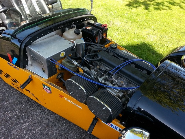

When i was thinking of spending 500 on a X-flow head.. I had to stand back and think...
And .. 200 later a 2.0L Zetec was fitted it into a small low line body - Ron's build yer own...
no more oil leaks - 155bhp - very happy bunny..
