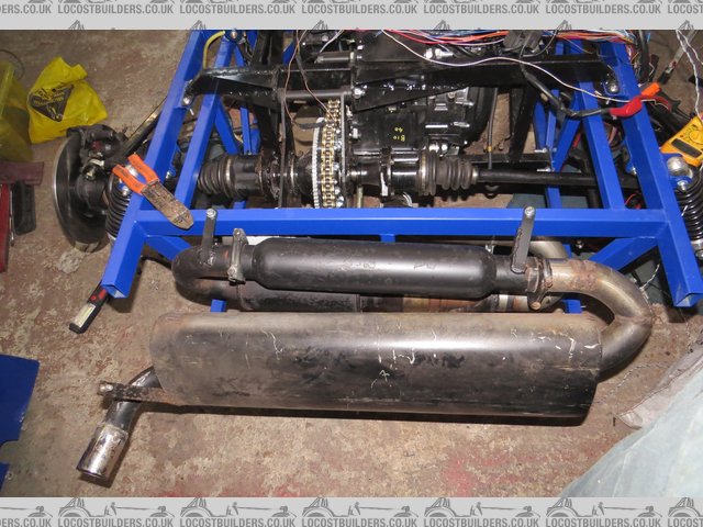

Day 17. Almost at the point where I can start the engine & then start the laborious job of remaking the loom. But first need to make up the front end of the exhaust, if I ran it at this stage I think I'd be deaf fairly rapidly! The back end is a unit I use for IVA as it's nice & quiet & has a CAT in it, this late engine probably doesn't need the additional CAT, but that's something to play with further down the line.
Here you can see the bike CAT, I have cut away the rear section of the exhaust where it splits into 2 on the bike, I weld a new section onto this to connect with the rear part of the exhaust

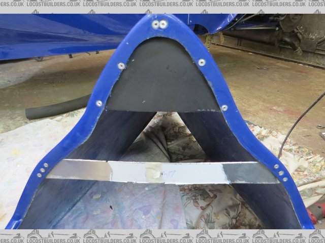

Within the wing itself there is a substantial composite "board" along with vertical ali stiffeners to make sure the whole wing is strong enough to withstand these forces

just an observation (and you know generally I really like this car and would love one if I had the cash)
you've mounted the tank filler to the top of a side pod... so in a crash where the side pod is hit, maybe not even knocked off, it's going to pull the hose right off the fuel tank and let petrol spill out.
I'm not keen on this
Even if you kept it located there I'd have liked a substantial structure mounted to the chassis side that held the filler so in the event the side pod was knocked off the filler would be unaffected. With all that empty space in there a protective frame could have been made to go over the tank to further improve things.
My old landy has a similar location for it's fuel tank and I have used extra outriggers and tube (scaffold) to protect it, maybe ott for your car but the same idea.
Keep going though, great post
Entirely fair & intuitive comment, always happy to receive constructive feedback.
In fairness for what you describe to happen would require a particular set of circumstances - first you'd need to brim the tank (which I almost never do, the exception being if I'm doing long distances & want every drop available), which you will note is set at an angle to aid fuel pickup at the rear when fuel is low, due to the tank being relatively tall & narrow, fuel level drops fairly quickly away from the top, so the accident would need to be within the first few miles after filling. For the sidepod to get ripped off would in itself require an unusual set of circumstances in a road accident, & remember the car is designed primarily as a road car (on a track I could envisage many scenarios where a sidepod could get taken off). The sidepod is pretty rigid & obviously protected to a certain extent from both front & rear by the wheels, if hit direct in the side I would be more worried about the whole tank rupturing rather than the filler getting ripped off, but a glancing blow from the right direction could certainly produce the scenario you describe. All the hot stuff is a considerable way from the tank, but that may be of no help depending how fuel is able to spread
I have built one chassis which at the customers request had an additional frame added to the chassis outriggers to give additional protection to the tank, but I doubt that would have helped much re the filler being ripped off. It's something which could fairly easily be protected, probably simplest way would be to foam fill around the filler neck, would have to be done after IVA as it's an area they want to be able to see. It's obviously an area which can be addressed by any individual builder, I supply the kit, how it's built is up to them.
Alternatively the whole sidepod could be additionally braced & foam filled - I guess it depends how much you worry about these things, I know whether I'd rather be in a 7 (or indeed most other low sports cars), in a side impact or the Furore where you are substantially protected to shoulder height
Doing the foam filled thing would of course lose the "luggage space" within the sidepod - it always seems to amuse people when I arrive at a car show & proceed to remove my rucksack & folding chair from the N/S sidepod!

Day 37, finish off the last bits of bodywork fitting which is the cover for the passenger seat/front half of airbox. Wheels & tyres have now arrived so I can now get the mudguards fitted, final bending of the wheel arch stays is done on the car over the wheels/tyres being used as that way best fit is achieved. Wheel arches are marked on the outside with masking tape to show where the stays lie, essential to rough up both the internal fibreglass of the wheel arches & the mating face of the stay to allow the Siraflex to get a good grip. I don't like unsightly bolts!
[img] Description
[/img]
[img] Description
[/img]
[img] Description
[/img]
[img] Description
[/img]
[img] Description
[/img]
[img] Description
[/img]
[img] Description
[/img]
[img] Description
[/img]
