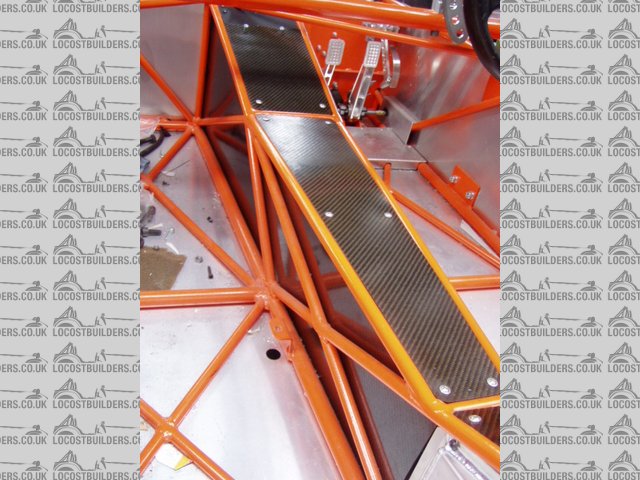

SPYDER
posted on 21/4/17 at 08:06 PM Reply With Quote
Here's my carbon tunnel...
We acquired a sheet of 1mm thick pre-preg carbon and cut the panels to suit.
