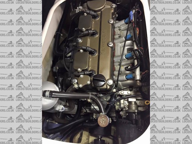

The tacho feed can pick up from switched side of coil, or an injector or the wire can be wound around an HT lead as an inductive pickup, tho' I doubt on a jetski you'd have exposed HT leads, I guess it's coil on plug?

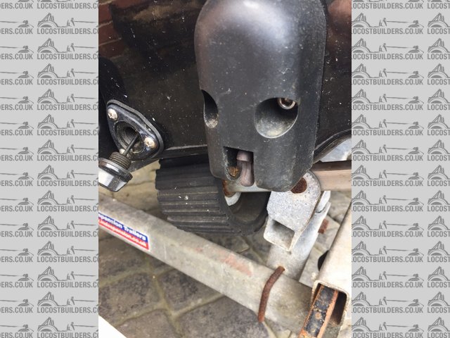

skydivepaul
posted on 26/4/17 at 05:41 PM Reply With Quote
Once again thanks for all the info.
Spoke to Acewell, who were very helpful with options for the jetski.
picture of speed sensor and engine bay just for your curiosity
