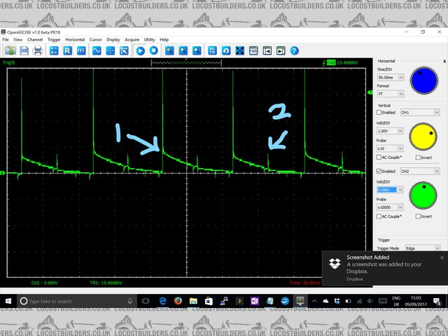

With your setup, every other ignition event captured is a wasted spark event, as your ignition fires the plugs as pairs, so only one is actually igniting fuel, the other is sparking on the exhaust stroke - this will give a different waveform to the ignition event.
Your captures may be better with 2 consecutive spark events on each, the lower kv one will be the wasted spark event.
Will your software allow you to overlay several captures so you can compare the burn time, peak kv and burn time voltage changes on the ignition event?
A couple screen captures from each cylinder with the full waveform shown may help to isolate your issues.

The varition between spark events on the secondary (HT) side of the coil is normal on a wasted spark system as every other spark is on an empty cylinder. I am short of time and will look at the vid in detail later. I wouldn't worry about the short spark duration as the coils are smaller the those on cars, most of the figures quoted for burn time are for US cars which tend to have much longer burn times.
You fuel air mixture looks okay but the ammout of hash at the start of some of the spark events is intersting.

What I would do first is capture and screen shot a parade of the fspark events on each cylinder by increasing the time base to cover a least 4 spark events, this will give 2 firing events and 2 wasted spark events on each capture --- to see any detail on this might be pushing an entry level oscilloscope to the limit but it should give you an idea of what is going on. The idea is to quote ignition diagnostic guru Jim Morton "looking at the forrest not the trees" to spot any odd balls or drop outs.
This spark parade screen cap is from a negatively fired wasted spark on a Rover note every second spark is a wasted spark with lower (less negative) voltage.
When capturing it will also help to increase the oscilloscope trigger voltage (decrease for negatively fired cylinders) so it triggers only on actual firing events not wasted sparks.
Were the replacement coils new ? as I suspect a spark is jumping to ground outside the cylinder, also I would attach the scope to the power side of the coil and look at the supply for dropouts.

So had another half hour in the garage today, gathered more information, but getting ever more confused
To answer some of the above questions: -
Airbox is missing, but it's not the cause of the misfire.
Earths from coil are the transistor switched earths via the ECU. So if there is an earth issue, it's general wiring and I'll need to re-wire a fair bit. Could test with a couple of jumpers, but might find myself doing a full rewire anyway if I don't get anywhere with diagnostics.
Definitely temperature related, doesn't start major dropouts until fully up to temperature.
I'll have a look on that scanner forum.
So to pictures, the 1st one shows one of the coils LT and HT side on one plug (+ve fire). I can see the cylinder firing (1), and the wasted spark (2). Oddly there's also a blip (3) which lines up with when the other coil fires. Not sure if this is just noise from the scope, or whether something is leaking in the ECU/wiring, or whether it's normal? Also the gradual drop of voltage looks like nothing I've seen in other examples?
Next is HT on a +ve firing cylinder (both look similar), you can see the firing (1) and wasted (2). Has the strange voltage drop-off too.
Next is HT on a -ve firing cylinder (both look similar). The big thing to note is that the voltage slope off after oscillation starts MUCH higher (...lower, as it's -ve but you know what I mean).
The fact that it's the same on BOTH coils in the -ve side means that either ALL my coils are broken (I've tried 5 different coils), there's something at the ECU, or there's some other weird thing causing an imbalance. I've swapped cylinders +ve/-ve too so 3 with 2, 1 with 4, and the oddness moves with polarity, so I don't believe it's specific to cylinders.
Finally a +ve signal during misfire events - I believe (1) is a misfire. Simply don't see a high voltage. So is this a coil not charging properly so nothing to fire with, or a HT short circuit meaning there's no resistance or something?
Hope some of this makes sense to someone? Might have a bit more time to play tomorrow, but will have a look at the scanner forum too.

It looks like when the misfire happens the coil is not being fully grounded by the driver in the computer

Oddly that chart is normal running not a misfire event?

I think your ht pickup is loosing its zero volt point, and is allowing the detected voltages to wander.
The lt side should directly mirror the ht trace (with a good coil, i dont think you have 5 faulty ones), but it is not according to your traces, and has the coil sticking at 4kv after firing event and then -2kv after wasted spark event - this is unlikely to be occuring.
I have had similar things with dc amp clamps when a current higher than can be read is passed across - which offsets the zero point. It may be that the peak kv is higher than your pickup can detect causing similar issues.
Has your daily driver got accessable ht leads to get a comparative reading from a known good system?
From what i can see, you may have a drop in compression for your misfire events, some traces from the lt side while the misfire is occuring will suffice to check this. If you can upload the traces somewhere and point out what software is needed to view the traces, zooming into each ignition event is required to give more detail than a screenshot can give.
