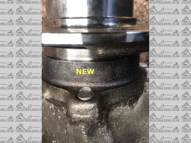

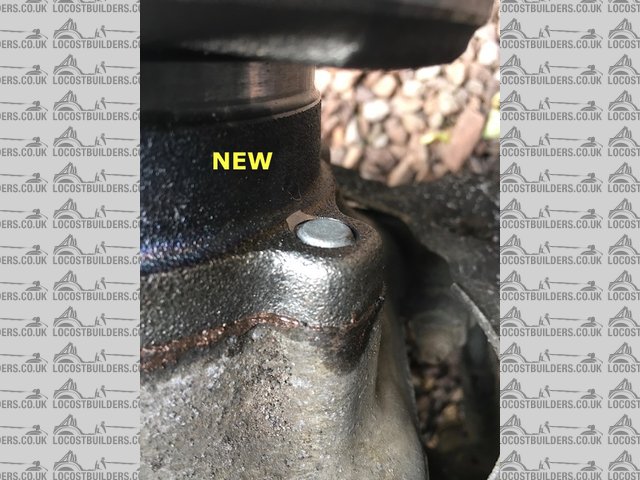

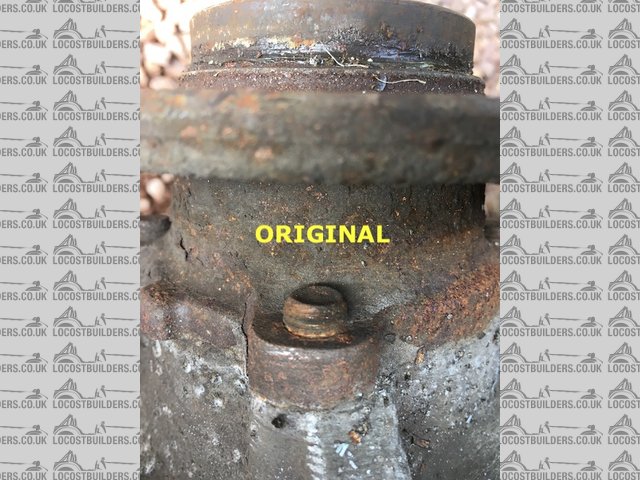

I replaced a pair of front hub / bearing assy's this morning on a BMW.
First pic shows the bolt protrusion on the original hub.
Second pic shows the (lack of!) bolt protrusion on the new hub.
I've double-checked that I've ordered the correct assy's.
What do the masses say? Perfectly adequate... or would you want to see some visible bolt threads?

| posted on 5/7/18 at 07:57 PM |
quote: Originally posted by Dingz
If all the bolt threads are engaged with the casting then thats fine. The spare bit of bolt protuding isn't doing anything apart from rusting.
It's difficult to tell. It looked like they were fully-engaged when I put it together, but my iPhone seems to have a better focus than my eyes
do, and they suggest it's bloody close.
Different angle below.
It's Evolution Baby!
