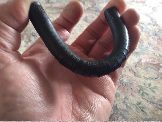

I'd be very wary of R9 from ebay, there is a lot of fake stuff about, I'd suggest more fake than genuine from subsequent conversations,
I bought some a while back, here it is after 2 months..
Fortunately It was over winter and the car wasn't used.
I only ever use Cohline from CBS now...
