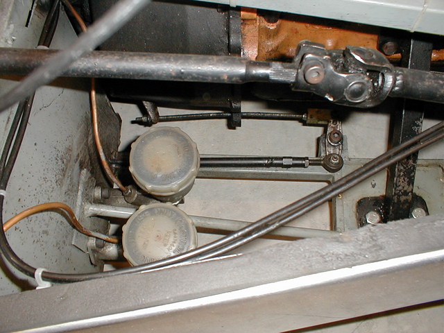

I used a pullrod on the Locost many years ago. The engine was solid mounted though.
Pullrod Clutch
Pullrod Clutch
[Edited on 11/10/20 by lsdweb]
Pullrod Clutch
Pullrod Clutch
Funny thing, I was thinking about the very same design and in a way I would prefer a rod to a cable. Less likelyhood of a breakage at the most inconvenient time. Good point about having a solidly mounted engine which I don't have. I hadn't considered that but any engine movement could give a bit of clutch judder. So that's a downside that I hadn't thought of.
