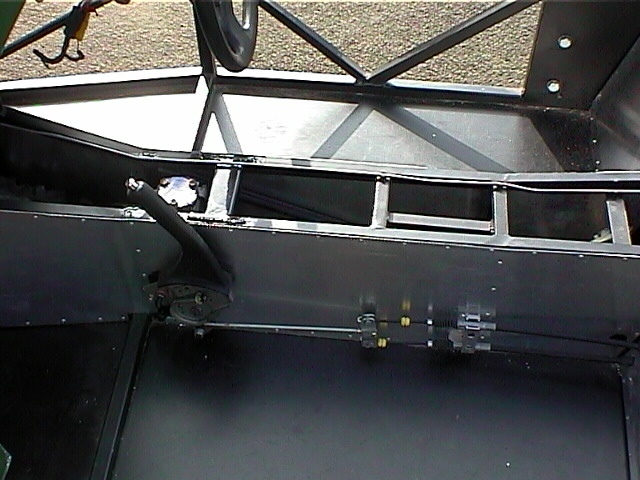

posted on 15/12/20 at 11:30 AM Reply With Quote
All Sylva designed cars (I think its all of them) are like this for a reason
Tunnel sides
Tunnel sides
Totally out the way and leaves the drivers elbow room to move about. Some do move it a little closer to the driver but that depends on seat choice and position.

Tunnel sides
Tunnel sides
I like that design approach - keeps the tunnel top clear and as you say, space for the driver's elbow!
