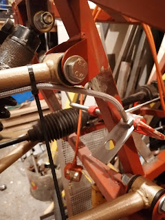

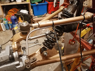

Flexi pipe routing check
I've done a trial fit of my flexi pipes, is this ok...
![](https://1.bp.blogspot.com/-005P-EElk8k/X9_TymYxi3I/AAAAAAAAD58/WBf4ooKF-QAvzCh6PKlDiVvYYMjRqwDfwCNcBGAsYHQ/s320/brake%2Bline%2Binner.jpg)
![](https://1.bp.blogspot.com/-4hmMv4xgWf4/X9_TypWTC1I/AAAAAAAAD6A/1BDqPdNDNFkPh0RzMw0ZWtRjP3v62NNNQCNcBGAsYHQ/s320/brake%2Bline%2Bouter.jpg)
It doesn't seem to chafe on anything as I turn the steering or move the suspension, but other pictures I can see on the internet suggest the
pipe going straight from the caliper to the car with no support at all. Should the pipe even be fixed to the wishbones?
[Edited on 20/12/20 by Slimy38]
posted on 20/12/20 at 11:47 PM |
Sorry but I don't like that and I don't think that would pass. As the arm is moving up and down it will rub on the arm which it's
just not allowed to do. I don't know why you're even attaching it to the wishbone at all, it should come out the side of the car in a
curved loop onto the caliper without touching anything. Once that's done you need to turn the wheels fully from side to side and full suspension
deflection and confirm the hose is never tight or coming into contact with anything.

Hello,
This does not look OK to me either.
Flexi lines shouldn't be attached, they should be completely free of movement between the 2 fittings (that is the reason why they are flexible
), except on some particular cases where they are very long and can have one intermediate fitting point, which is not the case here.
Hope that will help

Thanks everyone, I'm glad I asked and appreciate the guidance. I'll take them off the wishbone and leave them free.
