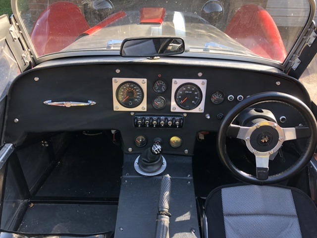

I picked up a set of new old stock VDO gauges for £100. It took a while but if you have patience itís surprising what bargains still appear there!
[img] Description
[/img]
