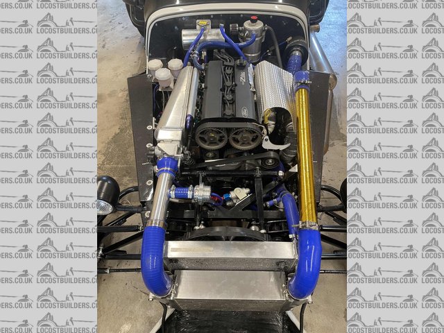

Zesty
posted on 13/6/21 at 07:10 PM |
[img]
![](/galpreviews/8DD53A7E-451F-4ECD-A25F-58C8AF9ABFF1.jpeg) ![MK](/gallery/8DD53A7E-451F-4ECD-A25F-58C8AF9ABFF1.jpeg) MK
[/img]

big_wasa
posted on 14/6/21 at 08:19 AM |
Before you do to much I would do some diagnostics. I would want to know charge temps, Afr's and everything else. Your charge pipes look fairly
skinny and the intercooler looks fairly small.
But a more efficient turbo might give more power at a lower level of boost and less heat.
