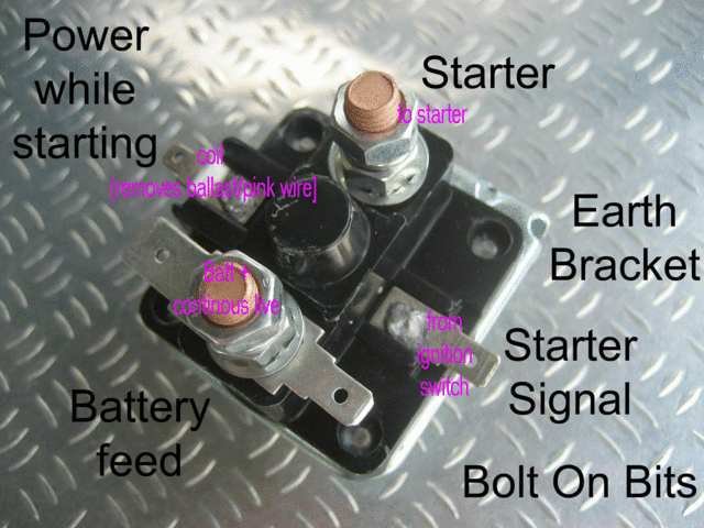

Am I correct in thinking that 3 wires are all linked to the positive... battery feed, ignition feed and switch feed and the other feed on the
solenoid goes to the starter motor?
theconrodkid
posted on 6/4/22 at 05:10 PM |
battery to battery +
starter to starter
starter signal to ignition switch start position, the other one is ballast over ride if the car has points ignition and ballast resistor

as above,
the ballast override, gives 12v feed to the coil, [taking out the ballast resister/ pink wire]. this gives an enhanced voltage to a nominal 6volt
coil, while the battery is supplying a high load (and hence reduced voltage)

I'll get my meter and identify the ignition switch feed and connect that to starter signal and put a spade connector on the wire which has the
push on connector and put that wire to power whilst starting connector on the solenoid and hopefully that will work.
I did try that yesterday but either the connection wasn't good enough or the battery wasn't charged enough.
