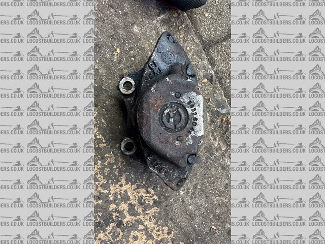

Hi guys,
I’m getting very confused with Ford calipers
Type 16
P16
M16
I need to order a rebuild kit and some pads, but not sure what I’ve got.
Can anyone help?

They could be cortina looking at the numbers but check before buying

M16 have metric fittings, P16 are imperial.
