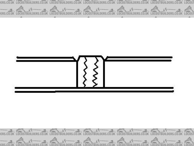

Try something like this, a hole in a short length of 12mm rod, drilled & tapped to 8mm, set into a 12mm hole in the RHS, weld into place, chamfer both edges of hole to give strength to weld. Grind weld off flush afterwards. You could go to 10mm thread in 14mm rod if you wanted more meat but I think it would be overkill. Also hole harder to drill & tap bigger & more expensive. Probably necessary to chase threads after welding as heat tends to shrink holes. Hope that sketch will help to make it clear.

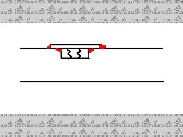

Stronger to use a top-hat arrangement I think... something like:
tophatbush
tophatbush
(grr Paint is awful - blue is the threaded bit, purple the weld/braze)
If you can braze it rather than welding there shouldn't be any distortion to worry about.
tophatbush
tophatbush
Whilst the top hat arrangment will certainly be very strong it will also be harder to produce & is probably overkill. The arrangement in the sketch in my 1st post should be well strong enough, if this rips out its likely to be the least of your problems at the time , if further strength was felt to be needed, then just drill right thru the RHS, make your piece of rod slightly longer & weld both sides.
