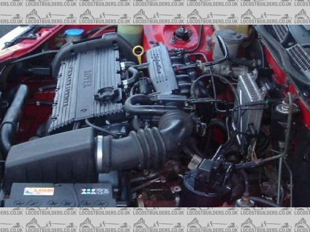

Anyone any idea if this is a K Series or Honda engine. The car is a rover.
ps hope the photo's attached.
Danozeman
posted on 12/2/06 at 09:26 PM Reply With Quote
Deffo K series mate.
Honda are mounted arse about face and look completely different.

Yep, definately K-series.

ok clever clogs, what capacity, what's it in, and what date was it manafactured?

Build date is between 96 amd 98 K16 Mpi
Rover new shape 200/400
One thing you can't tell is the capacity as 1.4 to 1.8 engines are externally identical when seen from the top. However the plastic throttle body skews he odds toward a 1.4 or 1.6 --- if it has an alloy sump it will be a 1.6 or 1.8.

Real trick is telling a 71 ps 1.4 from the 104ps version -- only one difference the throttlebody butterfly only opens halfway on the poverty spec engine.

k series
honda engine has gearbox on the other side !

To get that you have also to change the throttle cable for a longer one !
An extra honest 33 bhp no other differences even the ECU part numbers are the same ;-)

Originally posted by MikeRJ
Thought all the earlier 1.8's shared the same (horrible) plastic throttle body? My brothers '97 Elise has one.
Plastic throttlebody worked fine on the front engined cars but problems started apearing around the time the MGF 1.8 was introduced --- problem was partially extra heat but I also suspect mal-adjustment of the throttle cable was placing excessive force on the body.
MG-Rover changed a lot of plastic throttle bodies on customers cars a service time free of charge even though no problem had been reported.

I thought the 70-odd BHP 1.4 was infact a single cam engine?
Wikipedia (which could easily be be wrong) state 5 variants of the 1.4:
* SOHC K8 8-valve, Carburettor, 75 hp (55 kW)
* SOHC K8 8-valve, SPI, 75 hp (55 kW)
* SOHC K8 8-valve, MPI, 84 hp (62 kW)
* DOHC K16 16-valve, SPI, 90 hp (66 kW)
* DOHC K16 16-valve, MPI, 103 hp (76 kW)
The difference being different fuelling systems rather than a crippled throttle body.
I know from blueshift that the Mini One engine is basically Cooper engine with the DBW throttle map set to not open the throttle 100% so it does happen but I never thought it to be the case on the K.
I had a 1.4 in my old rover, pretty pokey for it's size (but still quite insurable), it could keep up with blueshift's 2.0 Primera (but I think that was a bit shagged)
