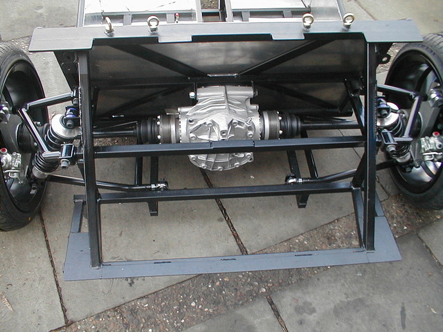

posted on 3/7/06 at 04:41 PM Reply With Quote
i didn't like the way tiger had done theres so i changed it...
Rear end
Rear end
