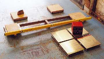

If you go and poke your head round a race car supplies shop you'll see lots of corner weight scales for a for £k's.. these give the weight
in Kilo's of each wheel, so its very easy to see what happens when you adjust something.

I've seen one of these Caraven nose weight
It has definiate potential although I can't currently work out how.... any suggestions?
best I have come up with is using two (due to the scale only going to 80kg) next to each other as a fulcrum and a long lever across the top....
