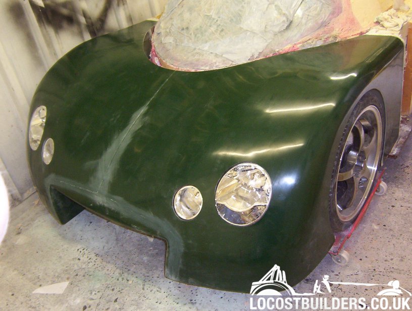

finally finished (ish) my front body panel! took some work but looks nice although it still needs some work.
heres some piccies!!-

here is the part demoulded, trimmed and sat in place. it popped out of the mould without a hitch but there seems to be a step where the middle split line is and a slight bulge on one side which must have been caused by heat as it isnt present on the mould. i always intended to have the whole thing sprayed in metallic racing green eventually so these can be sorted in the bodyshop after the car is on the road.

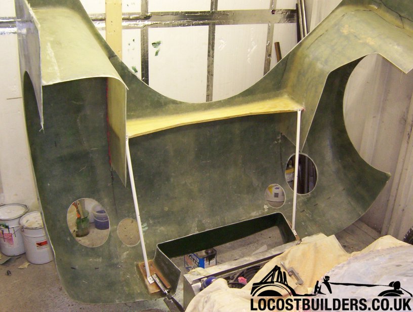

i also added some extra reinforcement to stiffen the part up a bit. the wood one i added before the demould and the ally tubes after it was was mounted due to it sagging when upright.
the whole thing is only about 3-4mm thick comprising 3 layers twill weave cloth and 2 layers csm alternating which is quite flexible but very strong. i can bend a 16inch long off cut right back on its self and it just springs back into shape.
and here it is with the headlights mounted (actually they are held in place with plasticine while i make permanent mounts which is the next task)
and now i can start the next part! bugger! all that and now i have to do it again.

Stunning work there Russ. I wondered if you would put returns on all the edges to make everything much stiffer, it is suprising how much strength that a 20mm return adds to the whole shell and there is less distortion too.

i would have done this but wanted to be able to trim most of the edges to get a perfect fit against the other panels. it is pretty stiff in all but the bits in front of the wheels, so it wont bugger the body work when i prang it! itll just bounce back into shape.

A friend of mine added a bulkhead to his nose section to add stiffness like you have. He also got some deflection to the shape caused by the heat of the grp setting off, he was told in future to graft the bulkhead on whilst he panel was still in the mould, this should reduce or eliminate any knock on distortion to the panel.
