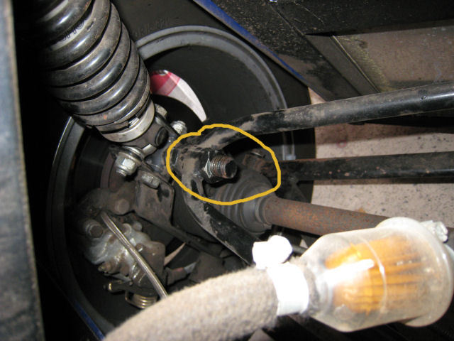

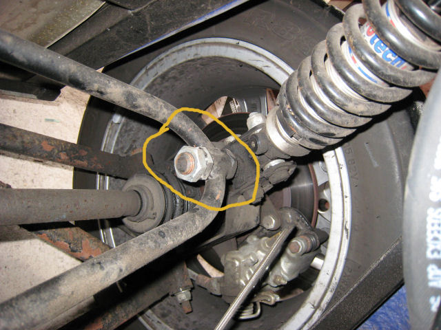

The pics below show my left and right rear upper wishbones. The left seems to have lost its locknut on the bit that does the camber adjustment. Does anyone know what size this is and where I can get one? Please ignore the liberal coating of CV joint grease! TVM

herrrm, i'd best check mine tonight as i'd lost one even before sva, i called mk and they posted me one.
Jubal
posted on 1/6/07 at 03:14 PM Reply With Quote
That's a result. I was going to ring them first but the thought of sending them a cheque for a single nut was holding me back!
Just rung 'em and it's a standard 20mm half nut. Job done.

If there's one part of the car that needs to belt and braces appraoch to threadlock and lockwire, it's those nuts!
I've heard a couple of stories of people finding a rear wheel seriously out of shape only to find the nuts had loosed competely off - not worth thinking about if it happens at speed
Pretty much what happened to me. Came off track and someone pointed out the massive degrees of camber I was running!

Loctite, lockwire, welded, tie wrap and cover in black nasty (just to be sure!)

We replaced ours a with a nyloc.

Both nuts with one nylock?
yep the outside ones not moved since

nyloc nuts, i'll second that .We lost one nut on our indy and replaced the nuts with one nyloc no problems since.
